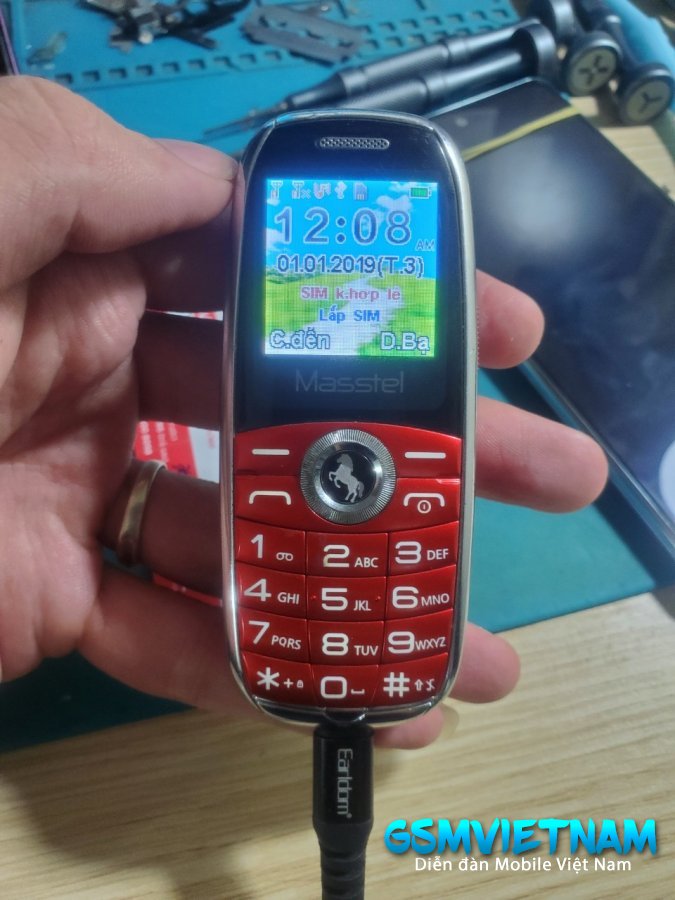

    Xoá mật khẩu Masstel Lux Mini
    Chinese Miracle II  [MTK module] v 1.58
    Operation : Format FileSystem [ v1.58 ]
    1. Power Off Phone , Remove battery , Insert back
    2. Insert USB cable. In some cases require hold BootKey ( '*' )
    Wait for phone...
    Phone found! [ 7 ]
    Sync...
    Sync Ok, read regs...
    Inital regs read done
    Boot Info :
    BB_CPU_ID : 6261
    BB_CPU_HW : CB01
    BB_CPU_SW : 0001
    BB_CPU_SB : 8000
    BB_CPU_NM : [MediaTek] MT6261_S0000
    BB_CPU_SN : 250A5A7B80864A9471541163A19A2CEA
    BROM Protocol Version : 05
    Setting...
    Setting done , result code 0x000E
    BROM stage done
    Seek and prepare DownloadAgent
    DownloadAgent matching HW Found!
    DA verify and select done
    Sending DA to target ...
    DA_INFO   : 0xC0 , Ver : 3.2 , BBID : 0x8E
    SOC_VERIFY : 0xC1
    BOOT_STYLE : SF_FLASH_BOOT
    NOR Flash IC initialized
    [0] : FLASH_VEN : 0x0113 , [Winbond] SF_W25Q32JV
    [0] : FLASH_DIE : 00EF 0070 0016 0000
    [0] : FLASH_LEN : 0x00400000
    INT_RAM : 0x0000D000
    EXT_RAM : 0x00400000
    Backup done
    Executing FFS FORMAT now...
    FAT_RANGE : 0x003A7000-0x003FFFFF , LEN : 0x00059000
    DA_RET   : DA_IN_PROGRESS
    DA_RET   : FORMAT_DONE
    Done!
    Elapsed: 00:00:31
    Reconnect Power/Cable!
