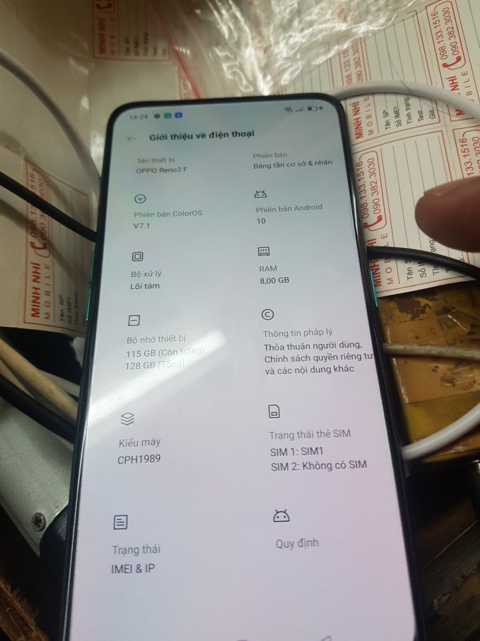

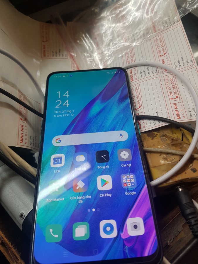

    Oppo Reno 2F CPH1989 xoá mã bảo vệ không tháo máy thành công,xoá trong 1 phút cho ae
    Operation : Oppo/Realme Factory Reset (Meta)
    Checking for existing META ports...
    Found MediaTek USB VCOM (Android) (COM5) on COM5
    Device Path : usb\vid_0e8d&pid_2007&rev_????
    Configuring Communication Channel...
    Reading phone information...
    CPU : MT6771
    SW Ver. : MOLY.LR12A.R2.TC16.Q.P70.PR3.SP.V1.P41
    HW Ver. : OPPO_P70_Q0MP1_K71V1_64_BSP_HW
    Starting Safe Factory Reset...
    Reset success
    Operation finished
