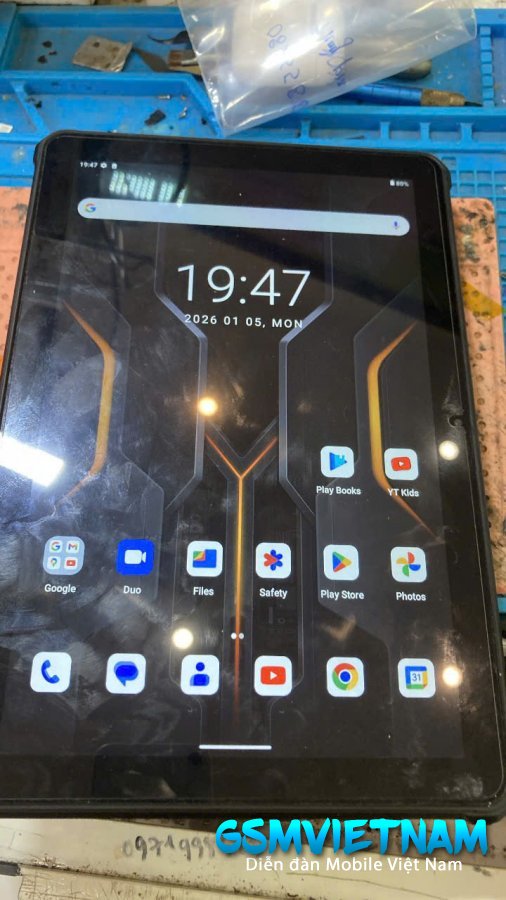

Dịch vụ Oukitel RT7 Titan 5G xoá xác minh tài khoản Google FRP
Thảo luận trong 'Dịch vụ Teamviewer' bắt đầu bởi Mobile Service, 5/1/26.
    1,509
    Bypsas frp lock Oukitel RT7 Titan 5G
    Welcome to Octoplus FRP Tool v.2.9.2.0
    Card S/N: 000X
    Work ID: 0000000X
    Platform: __GENERAL RESET FRP METHODS
    Selected model: MTK GENERAL
    Please, reconnect battery, press and hold "Vol+" or "Vol-" button and connect USB cable.
    Searching for a phone. Please wait...
    Found phone on COM3
    Port name: MediaTek USB Port_V1632 (COM3)
    Detecting Chip Version...
    HW Chip: MT6853 - Dimensity 720/800U: 0996
    HW Version: 8A00.CA00.0000.0000
    Brom Version: 05
    Connecting...
    Target Config: 00E0
    Sec. Config: SBA: False; SLA: False; DAA: False
    BootLoader Version: FE
    Brom Version: 05
    Searching Download Agent...
    Selected DA: MTK_AllInOne_DA_v3.3001.11/28/2021.05:37_580390, n.27
    Sending Download Agent...
    DA sent successfully
    Initializing DA...
    Synchronizing with DA...
    Mobile Status: SYNC
    Mobile Status: brom
    Sending BootLoader Info...
    Couldn't find loader!
    Download Agent is not compatible!
    Operation was failed!
    Performed by 2.9.2.0 Software version.
    Work ID: 000000000190B7A6
    Operation was canceled
    Work ID: 000000000190B7BF
    Found phone on COM11
    Port name: MediaTek PreLoader USB VCOM_V1632 (Android) (COM11)
    Brom Version: FF
    Connecting...
    Target Config: 0000
    BootLoader Version: 03
    Brom Version: FF
    Initializing DA...
    Mobile Status: SYNC
    Mobile Status: preloader
    Initializing Memory Flash..
    Initialization successfully completed
    Sending loaders...
    Mobile Status: SYNC
    Reading Flash Info...
    UFS Lun 0 : 4 Mb
    UFS Lun 1 : 4 Mb
    UFS Lun 2 : 244064 Mb
    Internal RAM size: 448 Kb
    External RAM size: 4096 Mb
    Reading partition...
    Reading SUPER partition...
    Reading info...
    Brand: OUKITEL
    Manufacturer: wheatek
    Model: RT7 TITAN 5G
    Device: P07
    Code name: P07_NFC_EEA
    Platform: mt6853
    Android version: 13
    Phone firmware version: 1701708715
    Display ID: OUKITEL_P07_NFC_EEA_V04_20231205
    Security patch level: 2023-11-05
    Active slot: a
    Searching for signatures...
    Switching to high-speed success!
    Resetting FRP lock..
    Error code: C002000C
    Backup saved as OUKITEL_RT7 TITAN 5G_05-01-2026_19-45-16.dump file
    Tắt nguồn cắm cáp để boot, không cần bấm phím
