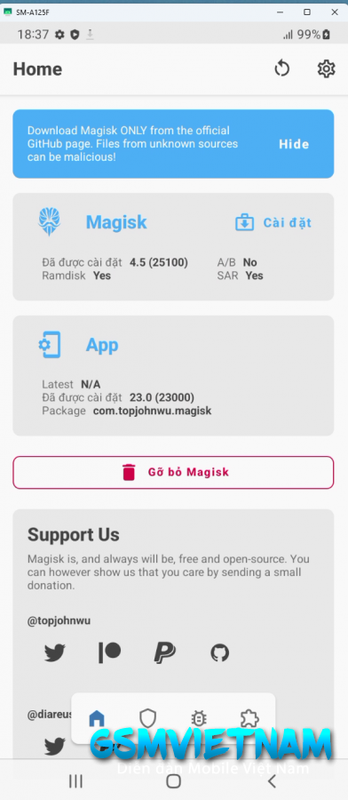

    Samsung Galaxy A12 SM-A125F bit 3 root by DFTPro
    Please, put your device in OFF mode and insert USB cable
    Waiting for MTK port : : 42
    Driver Info: MediaTek Inc.
    Driver version: 3.0.1504.0
    Driver date: 1-22-2015
    HW Chip: MT6765
    HW version: ca00
    SW version: 00
    HW sub version: 8a00
    SEC_CFG_SBC_EN: true
    SEC_CFG_SLA_EN: false
    SEC_CFG_DAA_EN: true
    MEID: 0x063F155FA5779902A9A6B6B4959B0540
    Brom exploit: OK
    Preloader name: preloader_k65v1_64_bsp_titan_rat
    Preloader verison: 35
    Send DA SYNC signal: OK
    Setup device enviroment: OK
    Receive DA SYNC signal: OK
    USB_SPEED: HIGH-SPEED
    Device mode: brom
    Init EXT RAM: : OK
    INT_SRAM: 224.00 KB
    EXT_RAM: 6.00 GB
    Send 2nd DA: : OK
    EMMC_ID: 3V6CAB
    EMMC_CID: 150100335636434142009448E4745873
    EMMC_BOOT1: 4.00 MB
    EMMC_BOOT2: 4.00 MB
    EMMC_RPMB: 16.00 MB
    EMMC_USER: 116.48 GB
    Reading device Info
    Brand: samsung
    Model: SM-A125F
    Device: a12
    Manufacturer: samsung
    Android version: 12
    Android cpu: arm64-v8a
    Incremental version: A125FXXS3CWF3
    Security patch: 2023-06-01
    Make Root
    Backup security partition
    Read Partition boot: OK
    Read Partition vbmeta: OK
    Backup Saved: Backup/ROOT/BOOT_samsung-SM-A125F(a12)-_2023_9_24_14_53_37.zip
    vbmeta verity: unlock
    Performing Unlock bootloader
    Unlock Bootloader: success
    Reset FRP Partiton: Done
    Reset samsung frp: Done
    Read root partition: : OK
    Unpack boot: OK
    boot firmware: info
    OS_VERSION: [12.0.0]
    OS_PATCH_LEVEL: [2023-06]
    Patch ramdisk to decryption: OK
    Clean ramdisk: OK
    Cpu type: arm64-v8a
    add root boot: OK
    Patch hex kernel: OK
    Patch boot: Succesfull
    Write root partition: : OK
    Remove warning logo: OK
    Operation time: 02:13
    Operation: Finish 3.0.8.0
