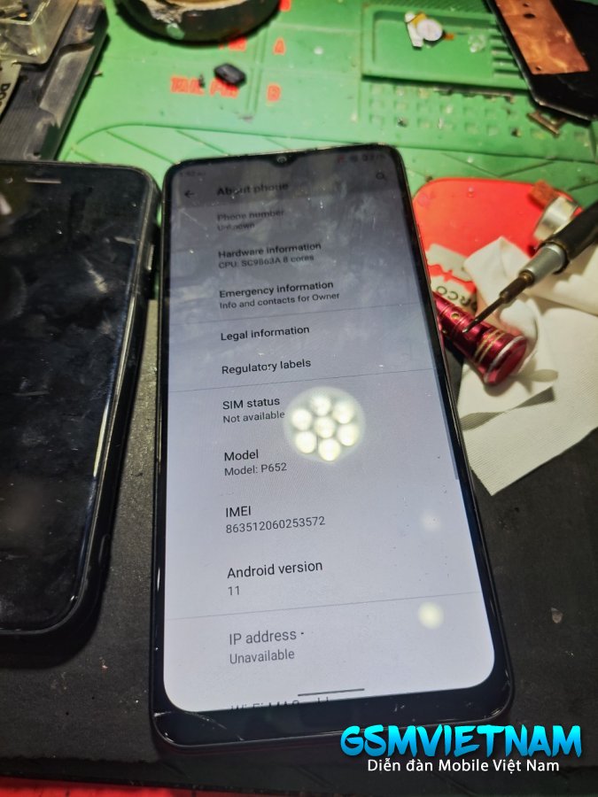

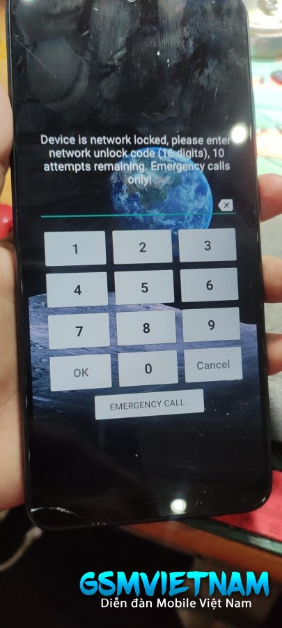

    ZTE Optus X Tap 2 khoá mạng mở thành công | Unlock network ZTE P652 successfully

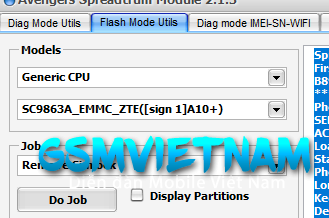

    Spreadtrum 9863a_3h10 Board
    First 16 bytes from public rsa key.
    B8928F81E592DF02E227A84968366708
    Phone Storage: EMMC
    SELECTED: SC9863A_EMMC_ZTE([sign 1]A10+)
    ACTION: SimUnlock
    Loader format:NEW
    Start Detect phone.
    Phone must be off with battery inside.
    Long press "VOL -"+ "VOL +" key while inserting usb cable.
    Keep key untill boot complete.
    Detected: SPRD U2S Diag (COM3)
    Sending loader, keep boot key untill loader start.
    Loader OK: Spreadtrum Boot Block version 1.1
    Changing bautrate OK.
    Send Second Loader.
    New flash metod detected.
    UID: THYW36_24_22_4
    [S]Manufacturer: ZTE
    [S]Brand: ZTE
    [S]Device: P963F61
    [S]Model: P652
    Build ID: RP1A.201005.001
    CPU arhitecture: armeabi-v7a
    Build product name: s9863a1h10_go_32b
    Build description: s9863a1h10_go_32b_2g-user 11 RP1A.201005.001 20230417.211353 release-keys
    Product name: Z6356O_1
    SW Version: OPU_AU_Z6356O_32V1.0.0B09
    Board: s9863a1h10_go_32b
    Build Id: RP1A.201005.001
    Android Release: 11
    Android Version: P652_M03
    Security patch: 2023-04-05
    CPU NAME: SC9863A
    NV partition: l_fixnv1_a
    IMEI 1: 863512060253572
    IMEI 2: 111111111111119
    IMEI 3: 867400020316638
    IMEI 4: 867400020316646
    Simlock Type: 4
    Simlock Status:
    SIMLOCK: ACTIVE
    NETWORK SUBNET: INACTIVE
    SP LOCK: INACTIVE
    CORPORATE: INACTIVE
    USER LOCK: INACTIVE
    [4]Simlock Type: 0  0
    Backup saved to: C:\Users\TrongNguyen\flashmode_nvram_backup\SC9863A_P652_M03_863512060253572_111111111111119_l_fixnv1_a_nvram_backup.tar
    Testing key 1
    Testing key 2
    Testing key 3
    Sim unlock and repair imei is supported for this phone.
    Integrity seems ok, proceed with unlock....
    Start write unlock, wait...
    [can take 0-10 sec]Wait untill phone restart.
    Exe version: Avengers Spreadtrum Module 2.1.3
    Log saved:
    C:\Users\Saved_Logs\P652_M03_863512060253572_111111111111119_sim_unlock_phone.txt
    Total Time: 00:01:19
    Done.
