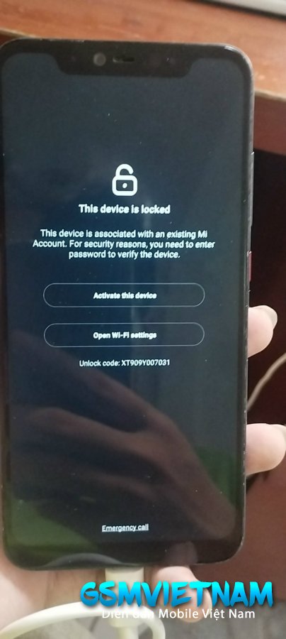

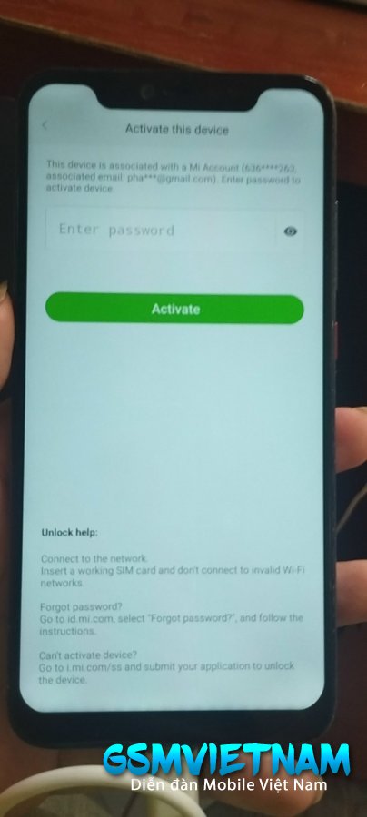

    Xiaomi Mi 8 Pro Dính Ẩn Micloud
    Xiaomi Mi 8 Pro Xoá xác minh tài khoản google
    Remove FRP - Micloud Xiaomi Mi 8 Pro
    This device is locked Xiaomi Mi 8 Pro

    [EDL] RESET | DISABLE MI CLOUD | OTA Selected Model : Xiaomi Mi 8 Pro/UD
    Code Name : Equuleus
    Operation : Disable OTA Update
      Authenticating... OK
      Retrieving data... OK [3.75 MiB]
    Initializing data... OK
    Waiting for HS-USB QDLoader 9008... COM32
    Connecting to device... OK
    Handshaking... OK
    Reading bootloader info... OK
      Serial : 4196579884 SoC : [Snapdragon 845] [SDM845] [0x0008B0E1]
      OEM : Xiaomi [0x0072] Model : Unknown [0x0000]
      PK_HASH[0] : C924A35F39CE1CDD1B8D5A9F3B8E3C51
      PK_HASH[1] : 317930431D7A9DD5A55028CF6965FE65
    Writing flash programmer... OK
    Connecting to flash programmer... OK
    Configuring device... Auth!
    Authenticating with server... OK
    Configuring device... OK
      Firehose config : UFS [Sector:4096] [Target:0] [Host:1048576]
    Reading partition map... OK - LU Count : 6
    Reading software info... OK [system]
       Model Name : MI 8 Pro
       Product Name : equuleus
       Manufacturer : Xiaomi
       Platform : sdm845
       Android Version : 10
       Security Patch : 2020-09-01
       Build : V12.0.1.0.QECMIXM
       Build Date : Mon Oct 19 21:49:23 CST 2020
       MIUI Version : V12
       MIUI Build : V12.0.1.0.QECMIXM
       MIUI Region : global
       MIUI Locale : en-GB
    Disabling MiCloud and OTA update... OK
    Disabling DM-VERIFY... OK
    Resetting MiCloud... OK
    Rebooting... OK
    UNLOCKTOOL 2023.09.23.0
    Elapsed time : 28 seconds
