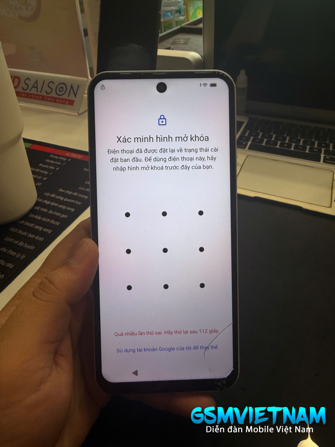

Thông tin Meizu Mblu 22 Pro bypass frp
Thảo luận trong 'Các dòng điện thoại khác' bắt đầu bởi Mobile Service, 3/7/26.
    Xoá xác minh tài khoản Google Meizu Mblu 22 Pro
    Driver Info: MediaTek Inc.
    Driver version: 3.0.1504.0
    Switch BROM mode: OK
    SEC_CFG_SBC_EN: false
    SEC_CFG_SLA_EN: false
    SEC_CFG_DAA_EN: false
    SEC_CFG_MEM_READ: true
    SEC_CFG_MEM_WRITE: true
    BROM_MODE: Available
    MEID: 0x21438773526D278B19FF2B18686CD3FB
    Brom exploit: OK
    Preloader name: preloader_m2512
    Preloader version: 40
    Send DA SYNC signal: OK
    Setup device enviroment: OK
    Receive DA SYNC signal: OK
    USB_SPEED: HIGH-SPEED
    Device mode: brom
    Init EXT RAM: OK
    Send 2nd DA : OK
    INT_SRAM: 448.00 KB
    EXT_RAM: 4.00 GB
    EMMC_ID: SCA256
    EMMC_CID: DF0118534341323536105A0923064C83
    EMMC_BOOT1: 4.00 MB
    EMMC_BOOT2: 4.00 MB
    EMMC_RPMB: 4.00 MB
    EMMC_USER: 232.94 GB
    Reading device Info [EROFS]
    Brand: meizu
    Model: Mblu 22 Pro
    Device: MEIZU_Mblu22Pro
    Product name: meizu_Mblu22Pro
    Manufacturer: meizu
    Android version: 15
    Display ID: AP3A.240905.015.A2.1760679840 release-keys
    Android cpu: arm64-v8a
    Android platform: mt6768
    Incremental version: 1760679840
    Security patch: 2025-09-05
    Activate slot: b
    Reset FRP Partiton: Done
    Erase FRP Partiton: Done
    Operation time: 00:45
