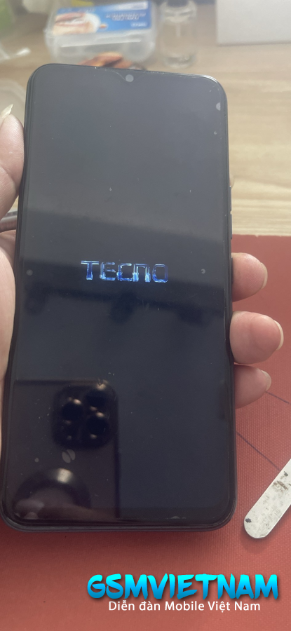

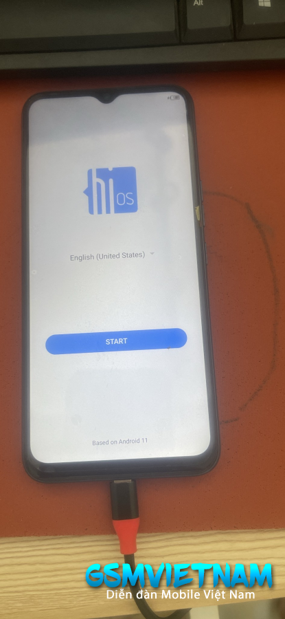

Thông tin TECNO Spark 8C ( KG5k ) Flashing - unbrick
Thảo luận trong 'Các dòng điện thoại khác' bắt đầu bởi CrackMobile.Net, 25/8/23.
    131
    Operation : SPREADTRUM FLASH
    11:32:35 AM - Waiting Spreadtrum Port... COM6
    11:33:25 AM - Connecting to Phone... Ok ( SPRD3 )
    11:33:25 AM - Using Loader From Firmware...Ok
    CHIP INFORMATION
     * FDL1 Base    ...     0x65000800
     * FDL2 Base    ...     0x9EFFFE00
    11:33:25 AM - Sending FDL1... Ok ( Spreadtrum Boot Block version 1.1 )
    11:33:31 AM - Sending FDL2... Ok
    11:33:35 AM - Initializing FDL2... Ok
    11:33:35 AM - Reading device partition table... Ok
    11:33:36 AM - Searching for desired partitions... Ok
     * Android Ver... 11
     * Build Date... WED JUN 14 12:06:26 CST 2023
     * Build Number... KG5K-F062-11.0-GL-V234-20230614
     * Chipset Type... ARM64-V8A
     * Device Brand... TECNO MOBILE LIMITED
     * Device Model... TECNO KG5K
     * Incremental... GL-V234-20230614
     * SDK Version... 30
    11:33:36 AM - Rebuilding device partition table... Ok
    11:33:36 AM - Erasing splloader partition ... Ok
    11:33:36 AM - Backing up l_fixnv1_a partition ... Ok
    11:33:37 AM - Flashing l_fixnv1_a partition ... Ok
    11:33:37 AM - Flashing Backup l_fixnv1_a partition ... Ok
    11:33:37 AM - Backing up prodnv partition ... Ok
    11:33:41 AM - Flashing prodnv partition ... Ok
    11:33:41 AM - Flashing Backup prodnv partition ... Ok
    11:33:41 AM - Backing up miscdata partition ... Ok
    11:33:42 AM - Flashing Backup miscdata partition ... Ok
    11:33:42 AM - Erasing uboot_log partition ... Ok
    11:33:42 AM - Flashing vbmeta_a partition ... Ok
    11:33:42 AM - Flashing vbmeta_system_a partition ... Ok
    11:33:42 AM - Flashing vbmeta_system_ext_a partition ... Ok
    11:33:42 AM - Flashing vbmeta_vendor_a partition ... Ok
    11:33:42 AM - Flashing vbmeta_product_a partition ... Ok
    11:33:42 AM - Flashing l_modem_a partition ... Ok
    11:33:46 AM - Flashing l_deltanv_a partition ... Ok
    11:33:46 AM - Flashing l_ldsp_a partition ... Ok
    11:33:48 AM - Flashing l_gdsp_a partition ... Ok
    11:33:49 AM - Flashing l_agdsp_a partition ... Ok
    11:33:51 AM - Flashing pm_sys_a partition ... Ok
    11:33:52 AM - Flashing gnssmodem_a partition ... Ok
    11:33:52 AM - Flashing wcnmodem_a partition ... Ok
    11:33:52 AM - Flashing boot_a partition ... Ok
    11:33:57 AM - Flashing dtbo_a partition ... Ok
    11:33:58 AM - Flashing super partition ... Ok
    11:40:39 AM - Flashing cache partition ... Ok
    11:40:39 AM - Erasing tranfs partition ... Ok
    11:40:39 AM - Flashing userdata partition ... Ok
    11:40:40 AM - Flashing logo partition ... Ok
    11:40:40 AM - Flashing fbootlogo partition ... Ok
    11:40:41 AM - Flashing socko_a partition ... Ok
    11:40:41 AM - Flashing odmko_a partition ... Ok
    11:40:42 AM - Erasing l_runtimenv1 partition ... Ok
    11:40:42 AM - Erasing misc partition ... Ok
    11:40:42 AM - Erasing sysdumpdb partition ... Ok
    11:40:42 AM - Flashing trustos_a partition ... Ok
    11:40:42 AM - Flashing teecfg_a partition ... Ok
    11:40:42 AM - Flashing sml_a partition ... Ok
    11:40:42 AM - Flashing uboot_a partition ... Ok
    11:40:42 AM - Flashing persist partition ... Ok
    11:40:43 AM - Flashing cover partition ... Ok
    11:40:43 AM - Erasing metadata partition ... Ok
    11:40:43 AM - Flashing splloader partition ... Ok
    11:40:43 AM - Flashing splloader partition ... Skip (Different storage)
    11:40:43 AM - Rebooting device... Ok
    11:40:43 AM - Elapsed Time... 00:07:17
    11:40:43 AM - Finished at local time: [25.08.23 11:40:43]
